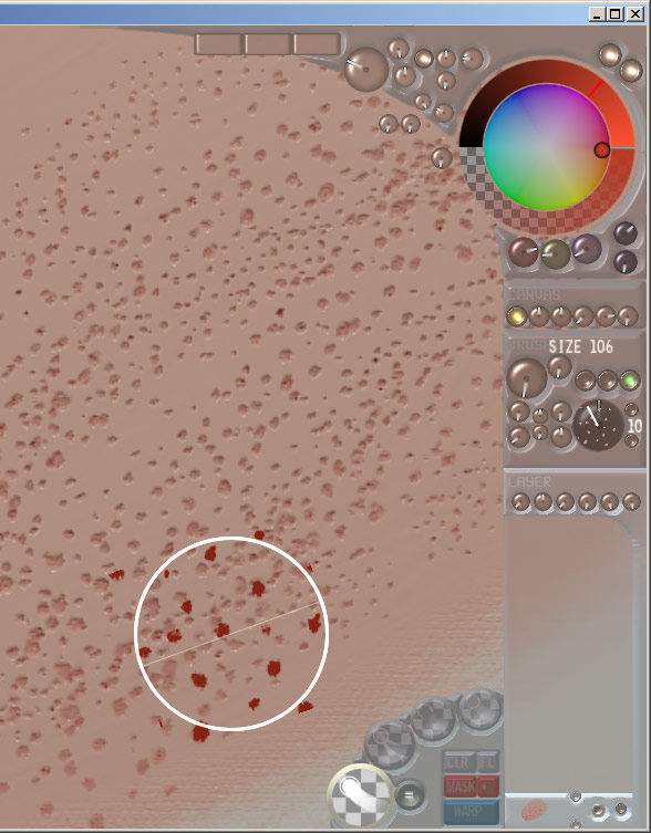

Post Sun Feb 14, 2016 10:23 pm
Re: Suggestions
"Negative build up"
Create negative bumps on a clean canvas and apply colour.
Thought about it while I was trying to make a pores - skin brush.

Post Sun Feb 14, 2016 11:53 pm
Re: Suggestions
Ok - that is working for the canvas, but I would love to make a image brush. That didn't seem to work.
No doubt I could do that in another app - just a thought.

Post Mon Feb 15, 2016 12:42 am
Re: Suggestions
Huh? That's weird. Are you talking about a brush with which you can create pore textures on skin?
If so, why would you not simply make a positive brush and then use it to erase at lower opacity? OOOhhhhhhh, you mean to color the pores at the same time?
Hahahahaha...that's so...man, after you do such fantastic sketch exercises you revert back to thinking about digital approaches that couldn't be further away from what you'd do with Verve? :lol: ... DOH!
Hmmmm...I'll think about it, maybe I just have the build up bipolar so you could go negative with it. :shrug:

Post Mon Feb 15, 2016 1:10 am
Re: Suggestions
OH, TRY THIS:
- make a positive pore image for the brush
- take it (duh)
- set paint mode to "=" (absolute)
- turn buildup down or even to 0
And now you can paint negative bumps at a color of your choosing! ;)
