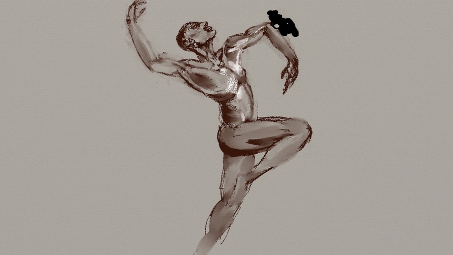

I think I've encountered the same bug. It is definitely black and sticky, anyway, although also until I restarted Verve it mostly took away the ability to draw anywhere on the canvas, and switching to = mode and erasing/smudging did not seem to work. Although making a duplicate layer and erasing with #2 brush did? I don't remember the exact steps tbh. I'm getting pretty sleepy....
figure study male ballerina.jpg (246.56 KiB) Viewed 43133 times
Here is original file:
https://www.dropbox.com/s/6f8180ozeaoa0 ... a.vrv?dl=0
Just as a BTW... Knacki, much thanks for the cheatsheet / tips & tricks post you put together. Your gallery postings are deeply impressive too.

I really would love to know what you guys were doing, haha... this is such a specific thing to accomplish. Thanks for the file. Switching to brush #2 and smudging and erasing worked quite well.
HOWEVER, I suggest, when you do drawings like this, do them in "=" mode! This way you avoid overloading material amounts and creating such strange differential chaos, though, Verve should know better. I don't know how or where this happens now. I was so sure I fixed it everywhere possible. OpenGL can do spooky things. :shrug: ...I will continue to investigate! :PP
THANKS! :ob

As far as I can recall, I was using [ctrl] to clean up that edge with #9, after creating a faint dusting with [shift] and blending set to 100% ...probably.
P.S. btw, is there no hotkey for blending parameter? I know [shift+b] toggles build up, and [b] tunes the same. Could we possibly get [ctrl+b] to tune blending in a future version? 100% is so useful for creating a smooth gradient with [shift] smudging , but 0% is better for... well, smudging.

BLENDING...omg, I keep forgetting about that, hahaha. Hmmm...funny, because I literally never use it. I made it in the beginning, which basically adds AVERAGING into the painting process. This could create weird stuff. Thanks! Just the hint I needed! :ob
