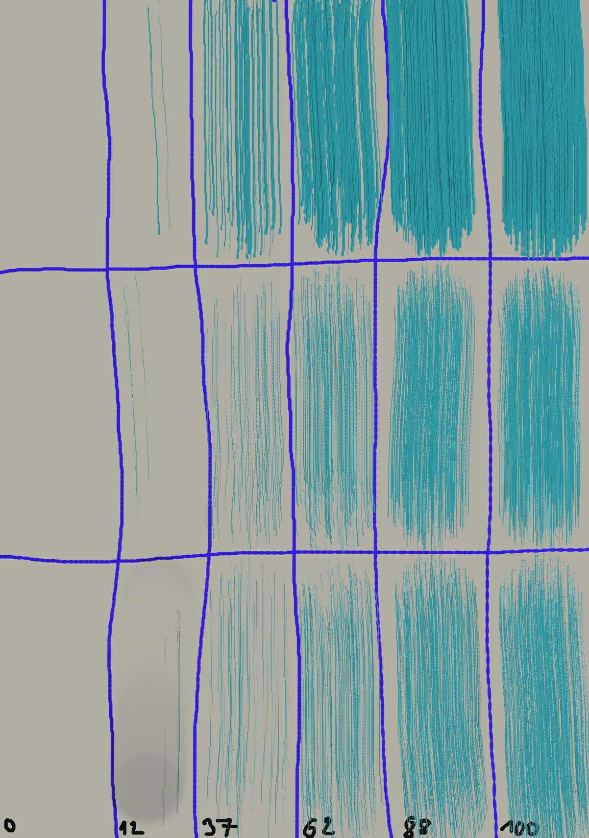

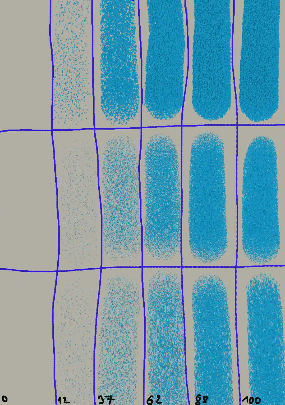

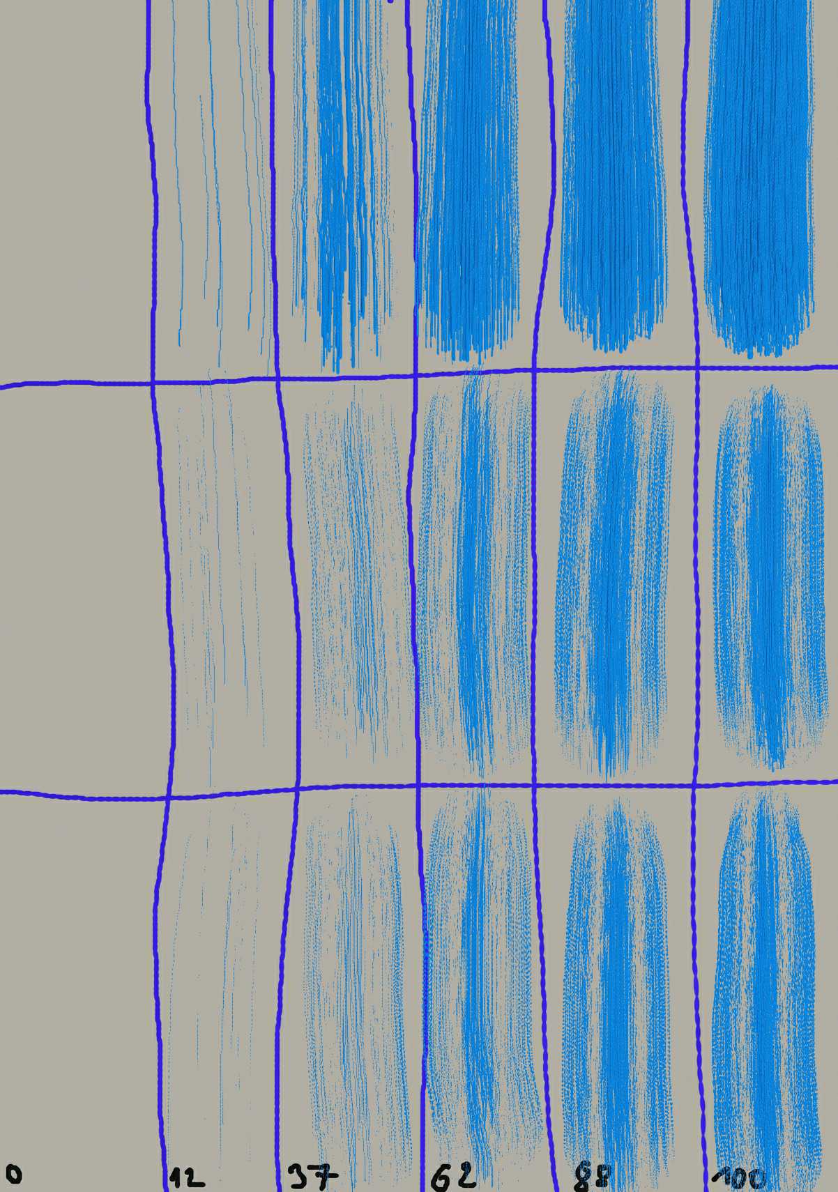

Brush #2 with Blending = 0
Here goes... I guess this thread is most strongly centered around the questions for which parameter ranges differences between the different brushes are most notable. And what parameters that I have ignored yet may make an enormous difference.
For a combination of high bristle count and high bristle size, Br#2 looks pretty much like Brush #5

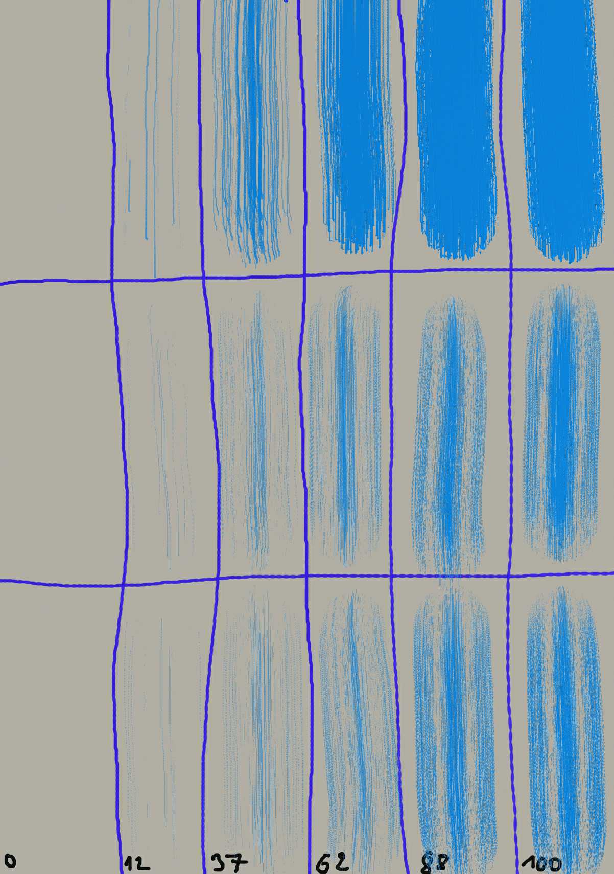

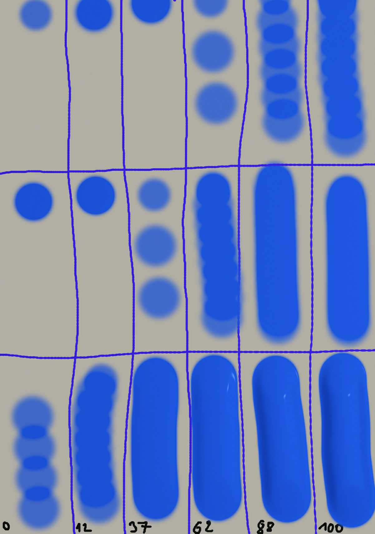

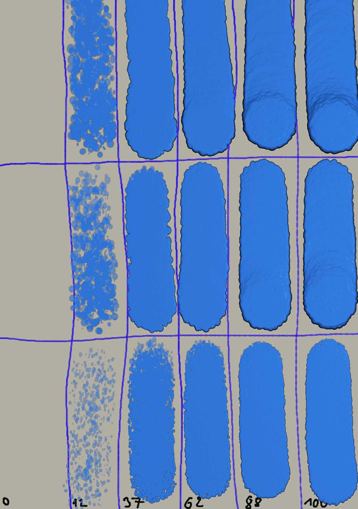

Brush #2 with Blending = 1%
And this is the stronly flattened version, achieved by changing "Blending" from 0% to 1%:

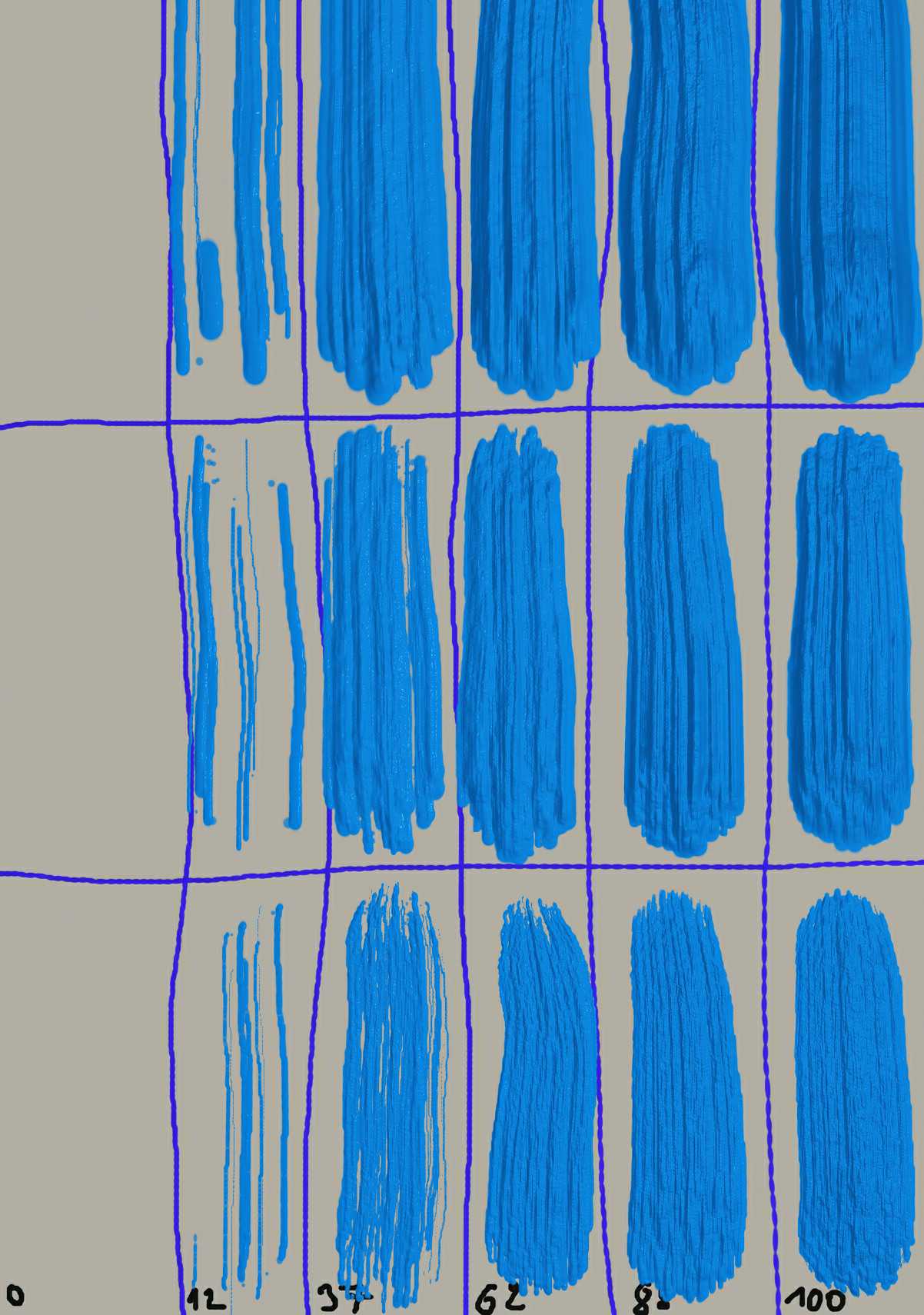

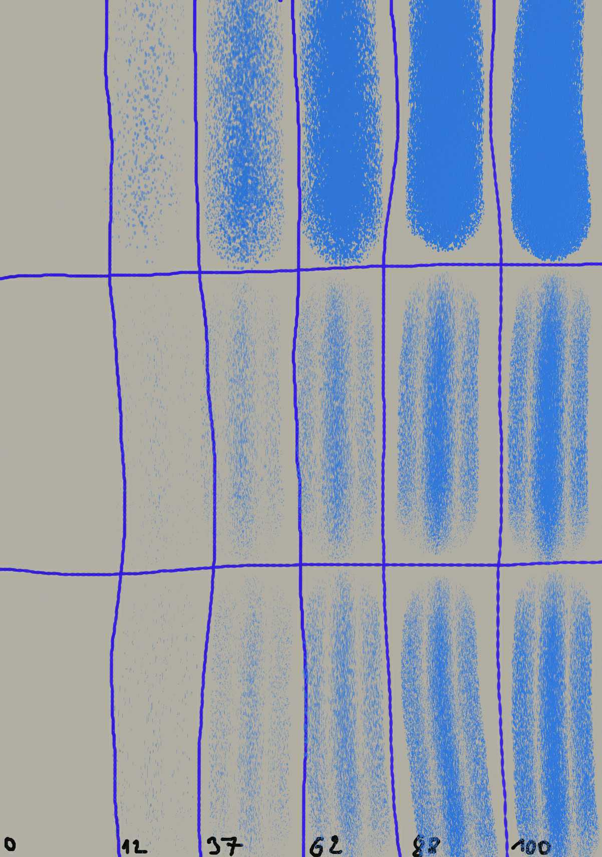

Brush #3 with Blending = 0
When I look at that Brush stroke's beautiful and rich inner structure for small counts compared to the larger counts, it really makes me wonder what I miss by choosing the wrong parameter settings... :PP

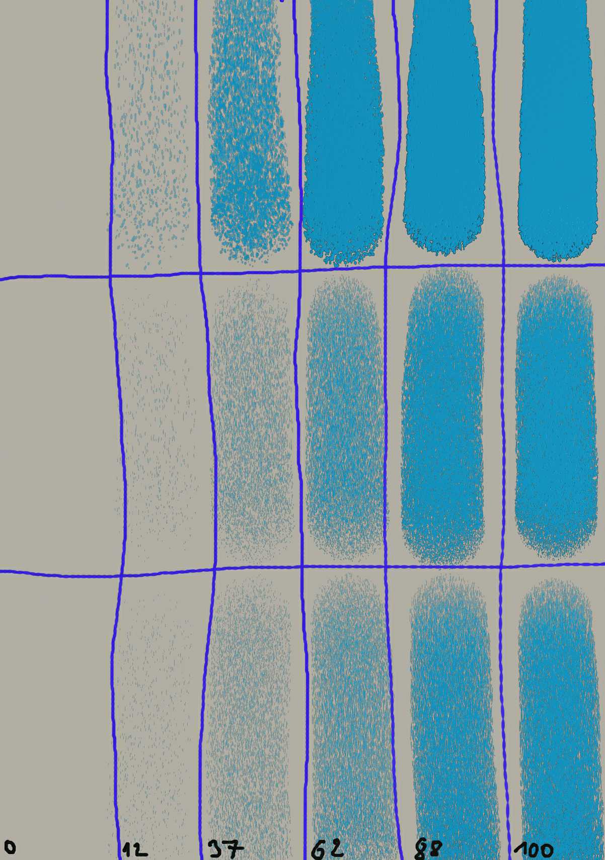

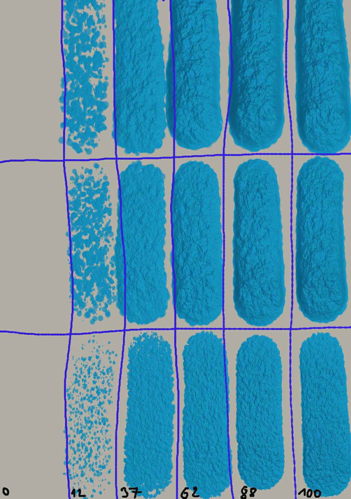

Brush #3 with Blending = 1%
But of course, even the higher bristle counts give you something of a strongly structured stroke with Blending = 0%
But a little change in one parameter makes for such a drastic change. What else might I lose??? :?

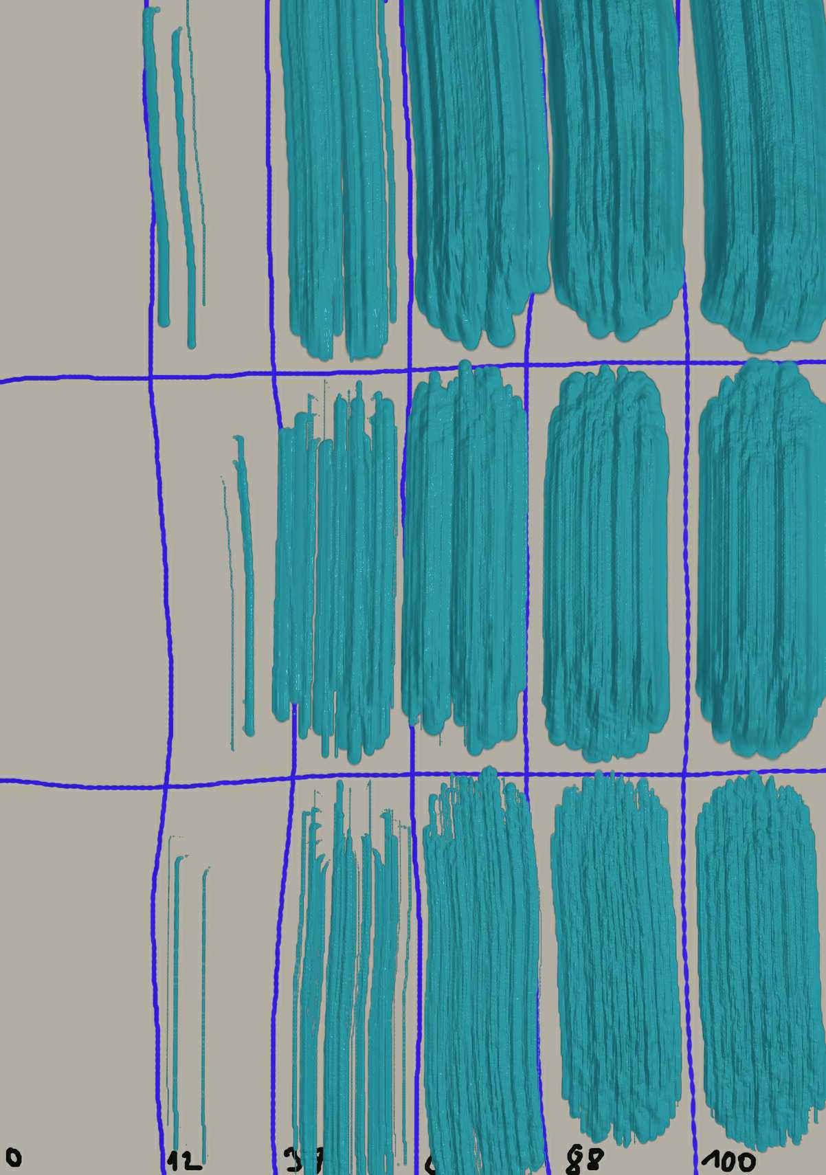

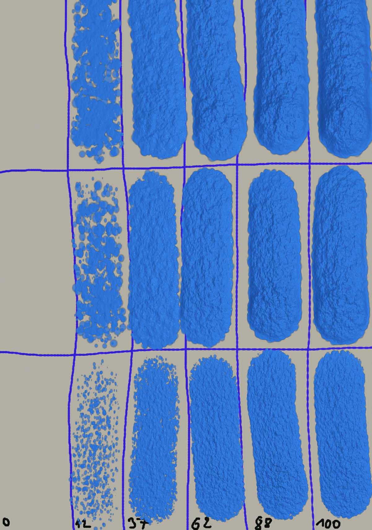

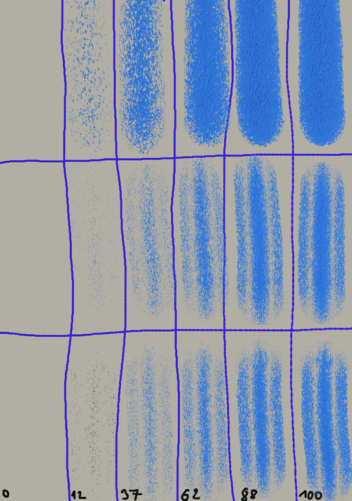

Brush #4 with Blending = 0%
For smaller bristle sizes, there is a clear difference between a middle part of the stroke and two side sections. But for higher bristle sizes, this totally gets lost and suddenly Brush #4 looks pretty much like #2...
And I also wonder: what was the idea behind this brush...

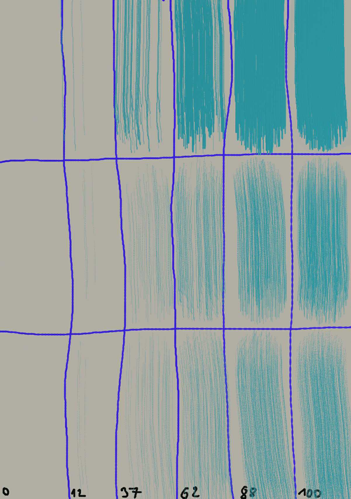

Brush #5 with Blending = 0%
Brush #5 seems to be something of a mixture between #3 and #4: roundish bristle imprits like #3 but the stroke has three different sections like #4.
But what is the unique characteristic of this brush?

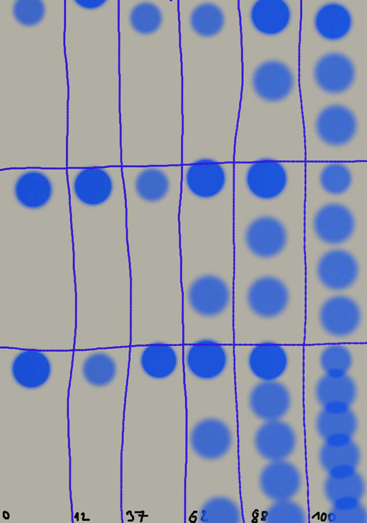

Brush #6 with Blending = 0%
I don't understand Brush #6.
AT ALL. :shock:
A brush that only acts as a stamp for circles? Why? This brush kind of consists of one bristle? :? :? :?
I love circles, I do. But what strength does this brush have?
And the bristle size acts totally unexpected - It doesn't influence the circle radius (which is, of course set by the Brush size anyway.)
If you say that this brush consists of one bristle, than it should be fully defined by the Brush size (so the bristle size should not have any effect) and the bristle count should not have any effect either, since it would always be one.
Only the bristle size and the bristle count both do influence the number of circles. But in different ways, it seems. :shrug: :shrug: :shrug:
