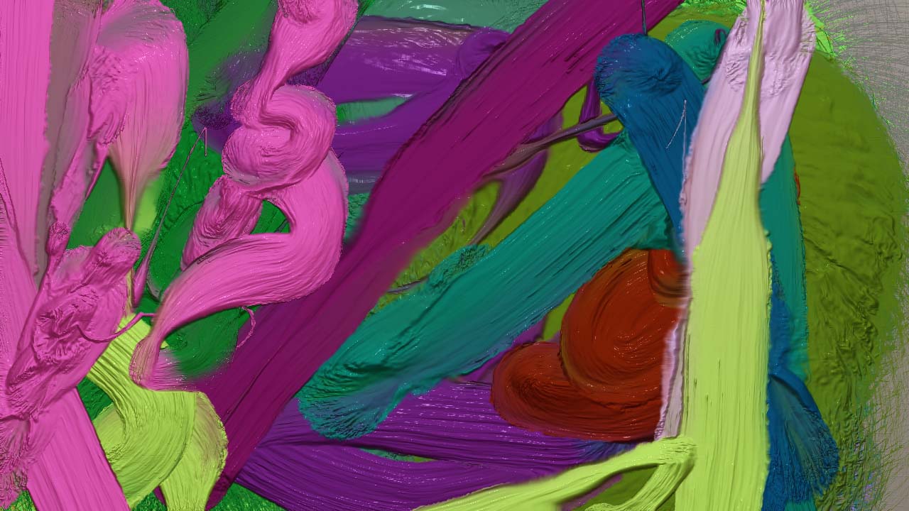

HEy RC
Thanks for posting the blender rend
I just tried it for the first time and the result is freakin me out!
As if the verve rend wasn't mind blowing enough!
Only problem I find is getting high enough res on the displacement map.
Any suggestions how to get more detail?
I tried using displace modifier and multi res…multi res seems less demanding.
OMG TARON!@#$%^&*(
THIS IS Crazy Beautiful Stuff!
My brain hurts just thinking about where your going with this!
Thank you
Thank yuou
Thank you
heres my test with original verve output for comparison

Thanks Lemivision!
Stavros: You are on the right track there. Ideally this would work best with micropoly displacement, which Blender does not have yet (Soon, once Pixar's open subD libraries get integrated,... it's coming) For now though, you just need to crank the subdivisions as high as your system can handle. I'm fortunate enough to have a 6 Gig GTX 780 that can render this all on the GPU. Even without that though, it renders just fine on the CPU, just takes a bit longer.
2 things that will help you,...First, use the Cycles renderer,... it is much better than the default render with lighting. It will calculate a full Global illumination lighting for your scene. Depending on your build, Cycles may be the default now, but you will have to learn a bit about nodes if this is new to you. Second, you can use the displacement as a bump map also. This helps the fine details show up without having to have the displacement carry all the fine details.
I'll make a sample .blend file for people to play with later. That way someone that isn't familiar with Blender can still load it up and render out a displaced image.

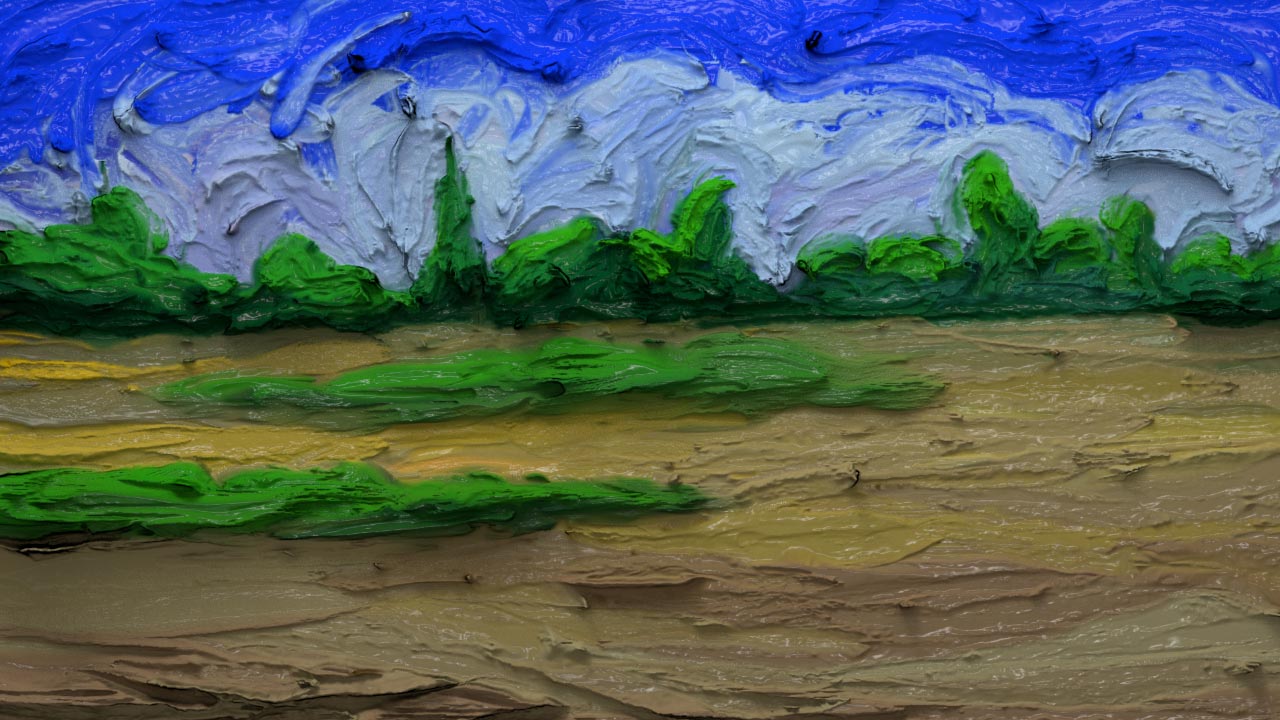

I loooove the soft tree line painting!

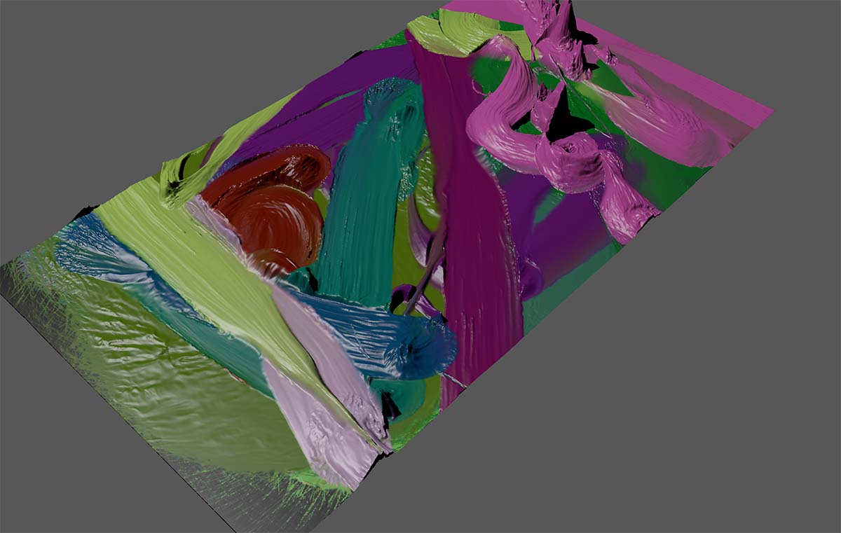

This is for anyone interested in using Blender to render a 3d displaced version of their painting. You will need this file and a copy of Blender. It's free at www.blender.org
Here is a link to the file you will need. You can use this to make your own renders.
http://www.pasteall.org/blend/33154
I'm sure this may create many new questions, so feel free to ask away.
Here is what the file looks like when rendered.

I tried rendering a crop of your file out at 500% and pixels are quite evident.
I see your textures are quite small so i expected it.
Heres my test with your lighting setup…and the verve render for comparison
interesting
A couple of questions…..
Why is the bump node being fed from col as opposed to mat?
and height as opposed to normal?
and
why stack 2 subs modifiers?
is it because of the 6 level limit?
Post Tue Dec 02, 2014 2:47 pm

Yea, I'm really liking the watercolor look right now. I'm adding in a bit of paper texture after the fact, but Verve is doing all the work here. I can add the paper texture in Verve using the multiply blend mode, but overlay looks a bit cleaner, so that is what I am doing as a post-effect. (just an overlay mix of the paper texture at about 15%)
