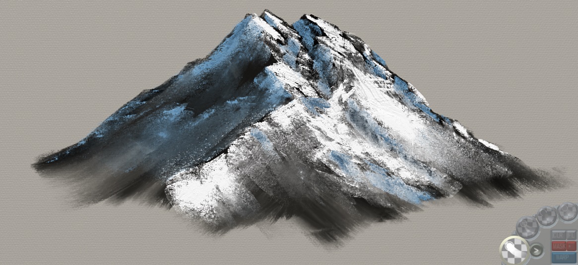

Thanks for looking into this, and thanks again for Verve! I really enjoy it and am really able to get some great results from it now that I have a deep understanding of its various knobs and adjustments. Just one example of what you can get out of Verve in minutes, that I've never been able to match in any other app:
