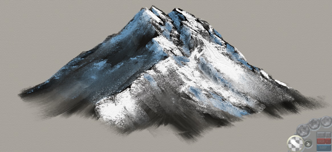

Hi Taron! I've been making more time to spend Verve'ing again, and am running into a repeatable crash. It seems to happen whenever I have certain brush images loaded into my painting, and then try to save. Once these brush images have been loaded, it will always crash when saving as a verve project, even if I delete all the brush images first. Here are some files that you can duplicate it with:

Thanks for looking into this, and thanks again for Verve! I really enjoy it and am really able to get some great results from it now that I have a deep understanding of its various knobs and adjustments. Just one example of what you can get out of Verve in minutes, that I've never been able to match in any other app:
