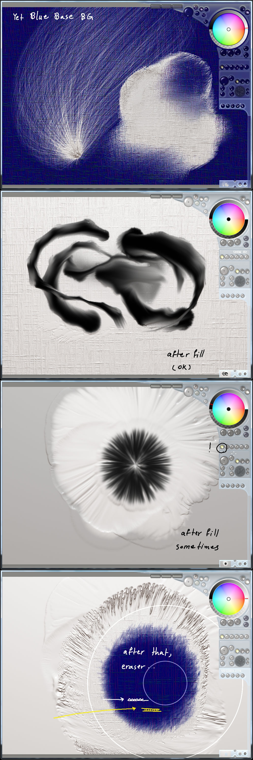

But in the final versions (t.x1.2.3.4 & u1), I observed different behaviors on different machines & versions.
One problem with the blue and white of the canvas texture !
and other is auto-off the canvas effects random-like !
imported images is ok when only one layer, but its auto-off when multi layers ...
I do not understand this logic. sorry & thanks *
http://s5.picofile.com/file/8126905734/ ... 7_tile.jpg
sorry, gist: at the first, canvas is blue / when import images is ok / when copy layer, texture is off

Ah, ok, the "copy layer" thing is logical and no bug. The amount of paint accumulates, you know. If I do not do that, it will look very strange, trust me!
The [ctrl]+[delete] thing is a good catch! I see this happening for a millisec, I just forgot to send a refresh to the canvas texture creation.
The blue thing, though, hmmm...that looks like a shading problem! I'll have to investigate. :|
I still don't understand how you get the blue background! What must I do to recreate that?

Most Excellent, borhani! I think I found the issue with the delete refresh and probably also the blue thing, although it didn't go blue for me...but I believe I know what it was! Let me know! :geek:
ALSO, don't forget: Each layer builds on top of the next. If you want a copied layer to still show the texture as if nothing was under this layer, you should just mute the layer below! ;)

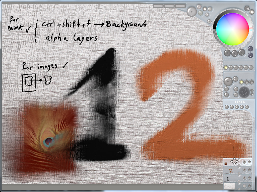

thanks for new beta but ...
after fill :
http://s5.picofile.com/file/8126911992/ ... 2_vert.jpg
refresh not work maybe ...
or main problem is the canvas base color ... even for minimal bump & texture ...
