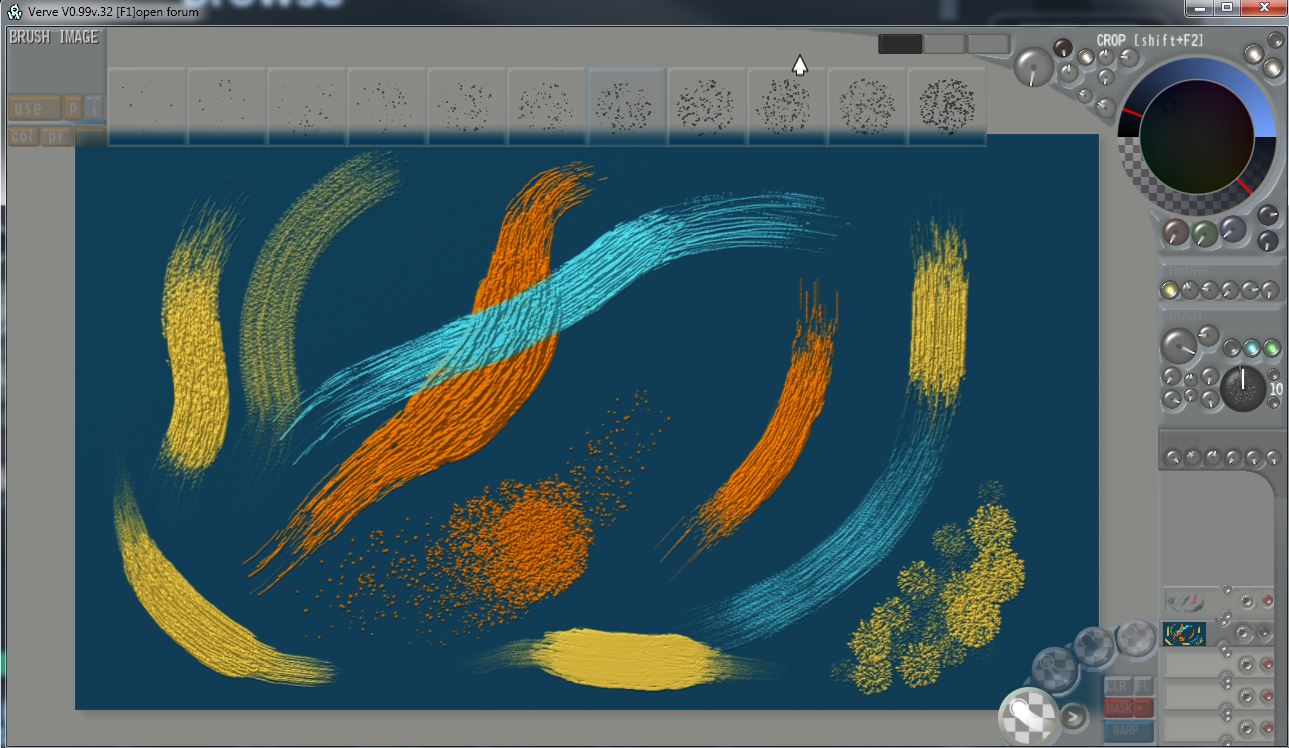

Besides this number of bristles to pen pressure it would be also a blast to have smudging on pen pressure.Well with less opacity it seems to be almost like smudging, but still a bit less effective???
Same could be with average.
Post Sun Mar 11, 2018 3:48 pm
Re: Suggestions
Just a thought knacki
If you want a smoother image bristle brush then try building each image from the previous one so the bristles remain aligned as opposed to each one being random....
Start the first bristle image....capture...add some bristles to the same image...capture again....add some more....and so on
Should give you a smoother stroke.
But yah smoothing is an issue
Post Sun Mar 11, 2018 4:39 pm
Re: Suggestions
Good point Stavros - but I have more a problem with spacing of image brushes, more clearly said.
With high speed on, one can reduce spacing, but it is not continuous, closed stroke.
The only brushes working without a spacing problem are #6, #7, #8 & #9.

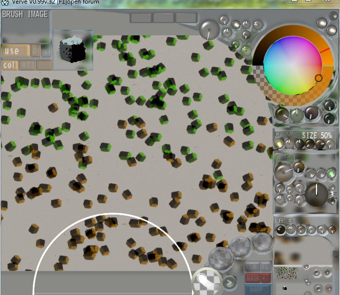

One tiny thing.
Brush 3 is very difficult to adjust in low bristle rate. 0-2% = nothing visible, 3% very fine dots, 4% already quite a lot dots, 29% completely filled stroke, 29-100% "only" big difference in build up.
This would be nice to have it a bit more balanced, as it can be used with image brush "particle" distributor.Something like 1-50% increased number of stipples until filled stroke, 50-100% build up difference.
On the other side, bristle size on 100% could be even bigger.
This could help with this kind of fun.
Oscilate to adjust for each bristle could be nice, but only if performance is same ;)
That's the big plus on brush 3.
Crazy 3d shit with fluids. Two stroke picture :D
