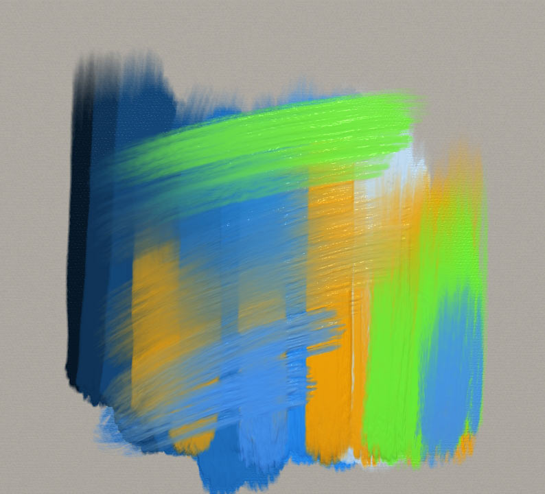

As with any real paint medium, the way you use them seemingly changes how they behave.
To get a nice thick oil like feeling, try using around 15% fluidity and turn off drying. You may want to lower the opacity of your color and activate pressure on opacity to force some more mixing as you paint gently.
- Everything matters!
The speed at which you paint as well as pressure and how it changes the brush size, if it should, all of this matters for the feeling you develop for it.
Fluid-smudge also has a severe influence on the behavior, which you should experiment around with.
Later on I may start experimenting with more "simulation" like approaches, having a "loaded" brush that may pick up colors from the canvas as you paint. I imagine for this to be pretty interesting then.

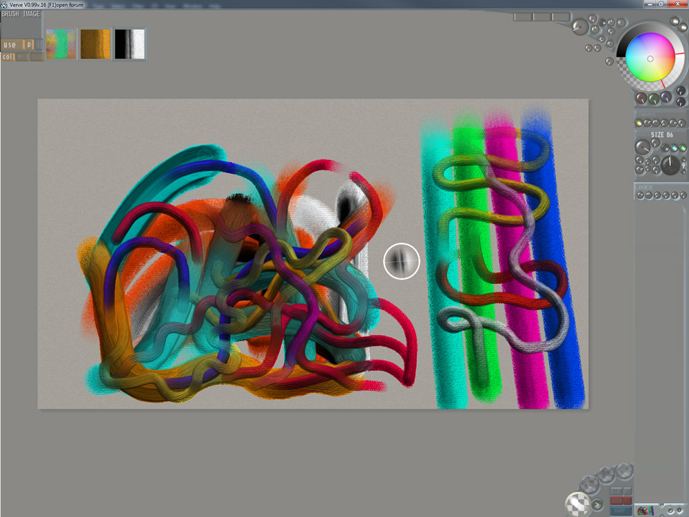

Post Tue Mar 01, 2016 6:53 pm
Re: Painting in layers (and mixing colors)
Hey zen,
what about that?
Thick-Oil.zip
(352 Bytes) Downloaded 1094 times
Play around with blending & build up, decrease blending for first layer!. Very less pressure almost just blends the colour. Slightly more and it is somehow mixing.
Stronger and it is opaque. Try it with Brush#2
Also play around with STRG+SHIFT+Stroke
You can "carve" brush structure in and mix colours.
As verve is not really loading colour from canvas, these would be my work around.
The other work around is to use an image brush and brush #9 to get a multicolour stroke.
Remember, even a brush with zero opacity paints structure.Sometimes helpful.
Cheers,
Knacki

Post Tue Mar 01, 2016 10:22 pm
Yes, go for it. ehh I mean zen, but no taron.........both! Both go for it :D
If you move your brush slowly with just a bit of pressure it will seamless mix when you slightly increase pressure. As said, best with opacity around 60%
Look at that!:
Posts: 177
Location: Trollhättan, Sweden
Post Tue Mar 01, 2016 10:35 pm
Thanks for the shot! :ob
Fauvist's spaghetti! :D
