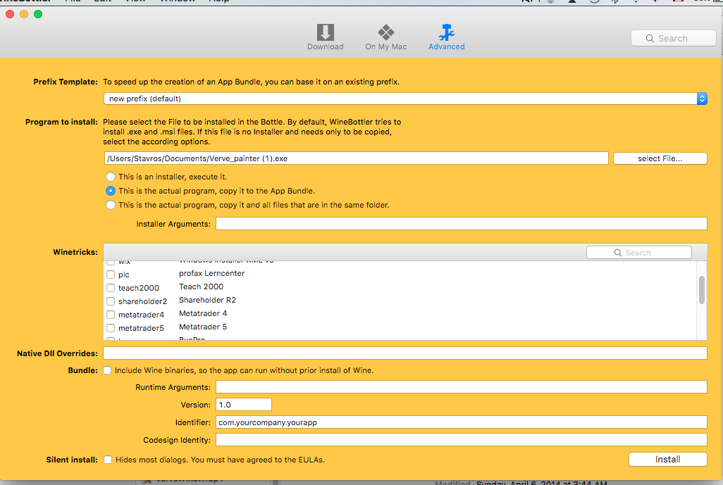

Post Mon Mar 07, 2016 4:17 am
Re: Verve works on mac via Wine
Here's a screenshot.
To get it to work, I used the winetrick that set windows version at 7, and allowed wine to update itself the first time I launched the app (make sure you update wine to the latest version as well, since they're always improving it). I also had to install the latest version of Quartz/x11. Additionally, I set the option to bundle the wine binaries inside the APP. Other than that, nothing. Only issue I have so far is that the color picker is one solid box and it covers up some of the dials. Performance seems to be fine so far too. I'm not on El Capitan, so I can't attest if it works on that.

That would be fantastic. You mentioned it could be a GL problem? I'll take a look if there's a GL related winetrick and try to re-wrap it and see if that works.

Post Mon Mar 07, 2016 10:53 am
Yes, a bunch of those shaders don't seem to work, but it's really hard to tell. The knobs should be transparent with a bump on them, but they just look black, for example. I'm almost surprised that the paint looks kind of fine.
