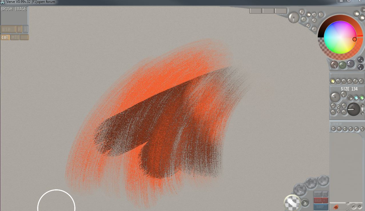

I guess it's not v32 specific but drives my seriously crazy.
I experience Verve as super lousy in painting on clear canvas, Very buggy, very strange to handle.
As long as one uses black, it‘s good, but as soon as one use colors it is getting strange on transparent or semi transparent parts.
One thing is the outer rim when changing colors, the other, and that bothers me much more, is this kind of "memory" of past and erased strokes.
This is an example:
The dark brown strokes were painted on an empty canvas, than visually completely erased.
When painting over, it's full visible again.
This happens all the time and is super annoying. I have to say, that I am painting with 0 Fluidity, as moving paint is not my fav in the moment.
Could that be the prob? I also don't like smudging for the same reason, as I too often loose myself in modelling instead of painting.
Any tips is really appreciated.

Re: Feedback v.0.99v.32
