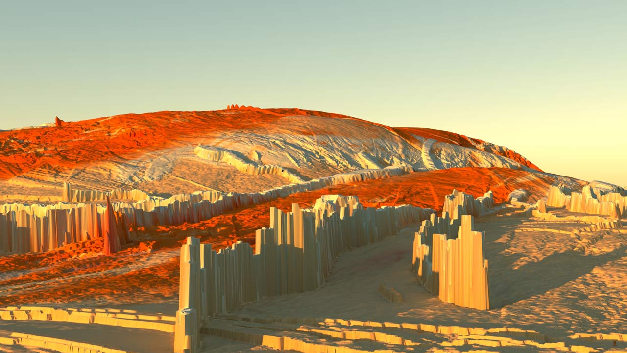

For an older version I made this. Most of it still counts:
Ahhh, there was a preset for blender & cycles somewhere...
Somewhere there, sorry don#t have time to search. Gallery is nice to watch anyway.
viewtopic.php?f=7&t=1400
