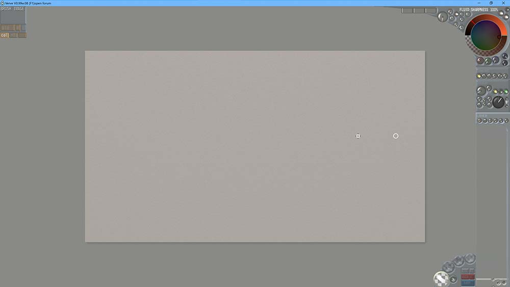

I asked Taron : @ Taron Speaking of Tablet apis lol I started out fresh on win 10 pro. Everything installed correctly etc. If I am using Wacom (old Intuous 3) Win Tab maintains pressure settings for all graphics programs. If I have Win Tab enabled for Verve when I start my stroke it never picks up until around an inch on the screen and then I control it as long as I can keep it moving. Pressure works but starting a stroke and not getting it where I need it from the beginning is really throwing me. If you take the pen and press down,, an inch or so to the right will show the Win Tab cursor? If I turn Win Tab off I get an entirely different behavior of course. I can start the stroke where needed but pressure doesnt affect Unless you keep the stroke moving and then it starts building up from a very thin stroke to very heavy as long as you damn near break the nib lol. Inside the wacom pressure setting it works fine. I cant do the fine detail I need to finish a current project.

Taron here are the screenshots. The larger cursor on the right is the win tab

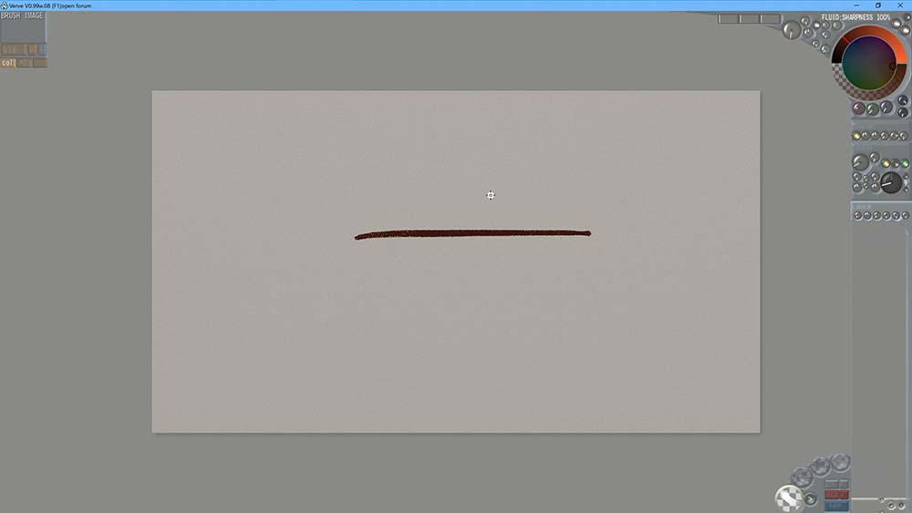

the second one shows approximately where the stroke starts from my pen. You can see a very rough approximation of distance from where the pen is in the first screenshot. Strangely on this one it built up almost immediately which is a first with this problem for me.

You must have replied while I was editing with screenshots lol. BTW in the first the pen cursor is me pressing down while win tab cursor appears to the right.

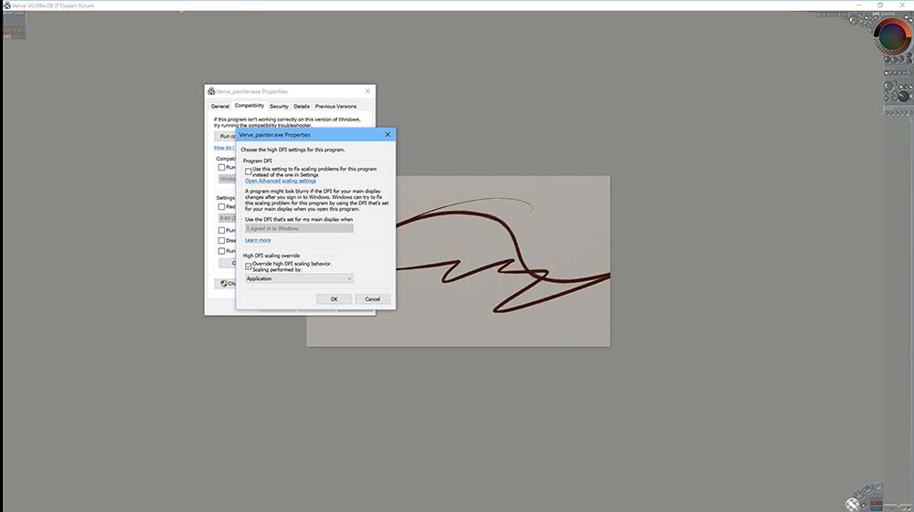

It is totally a scaling issue. I am using a 50 inch LG 4k tv as my monitor with a native setting of 3840 x 2160 with 200 % scale on. I have a pro 30 inch dell as a secondary monitor. Moving Verve to the dell didn't help because for some reason the scaling on the tv was also affecting Verve on the Dell. I am using a tv because I have the same issue as Pilou. My eyes are old lol With 4k on I suffer no loss in performance. I Do have Verve working now but in order to do that I had to delete the Verve settings and set the tv at 1920x1080 to match the Dell. Once I did that Verve works fine, I can see everything without squinting but I am taking a heavy performance hit because my cards operate optimally at 4k. Going in the compatibility tab didn't help but I may have missed something while I was in it and I will go back to it later after I give it a rest. The compatibility tab settings helped with Photoshop CS 6 and Sketchbook Pro. I haven't tried sculptris and Zbrush yet. To get back to my other programs I can reset back to native resolution.

ok I took a nap, woke up and dove back into compatibilty. Here are the settings that solved it but the scaling issue is transformed and I cant read the interface easily. Maybe with binoculars lol. Taron it appears I am in the same boat as Pilou, In order for me to use Verve properly again (I didnt have these problems a few weeks ago) I have to go to 1920. I agree with Pilou that scaling the UI from within Verve itself is very important. Mainly to old blind guys :D

AAAahhhhh, that is VERY interesting! Thanks, Tom!
Yeah, well, danged... the GUI needs the big push it's been begging for since years ago. I have so much of it prepared already, it's ridiculous. But, yes, I will do it.
I'm just happy you've figured it out, though, that's awesome! :ob ...now at least we know that there's something I can do something about! 8-)
