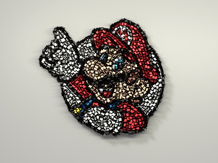

Some update :-)
I found a workaround of the above issues by drawing a first set with small tiles, then a second set of larger ones (same algorithm from Dr Di Blasi for both).
Before drawing each large tile, the trick is to erase its place with some margin in order to "insert" it nicely into the previous set.
Small tiles were possible despite the Verve restriction on square brushes, provided that they are long enough, like rice grains.
Here's an example, with a final rendering with Blender/Cycles :
regards,
GBoGBo
